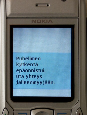

However, phones using Symbian OS 8.1a, such as the Nokia 6630, cannot recover the system directories, and thus fail to boot properly and display a message that instructs that the phone be taken into maintenance. Such phones can be recovered with a hard format operation described in the disinfection instructions.
